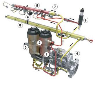

Tu ima te ?e skico kako to zgleda pri motorju kamiona Scanie. To je edino kar sem na?el. IMV ?t. 3 zgleda enako kot dizel filter in separator vode ?t. 2
1. Low-pressure pump
2. Fuel filters with water
separator
3. Inlet metering valve
4. High-pressure pump
5. Rail (accumulator)
6. Rail pressure sensor
7. Mechanical dump valve
8. Return rail
9. Electronically controlled
fuel injector
