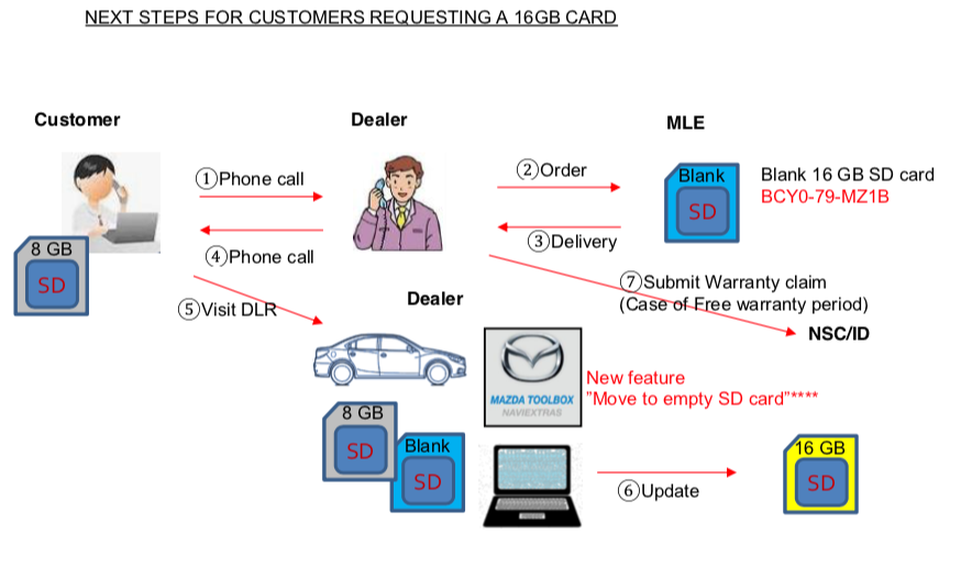

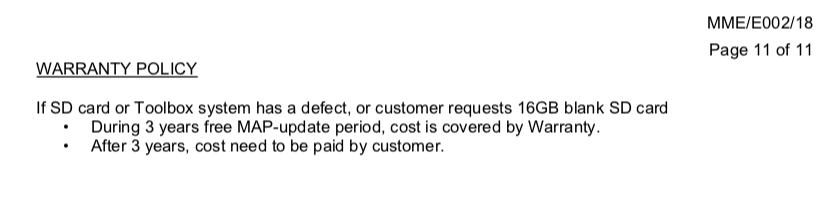

Menda jo na servisu zamenjajo za vecjo (16GB) ... ampak moras to zahtevati ... Vprasaj na servisu... ce to velja tudi pri nas ...
Screenshot_19_08_2019__19_57_230B1A99.pn
Screenshot_19_08_2019__19_56_230B1A6A.pn
Prilozen je cel dokument z navodili ... >> TSB New MZD Connect Map release - Split of Eastern and Western Europe DATA.pdf
