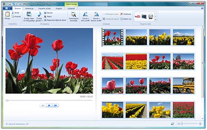

Microsoft Movie Maker mogoce >> http://download.live.com/moviemaker
