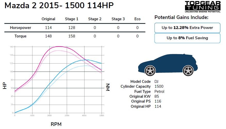

There are no hardware requirements, as the engines are the same between the two models. Mazda simply added a software throttle limitation to the 120 hp version at the top-end which can be removed by a tune There are a number of chip tunes available (one in Denmark and BBR GTI in the UK), and a full custom tune (Orange Virus) that can eliminate the limitation. However, after the limitation is removed, the chip tunes only give you 5-10 hp/tq gains over the 165 hp version (developing 170-175 hp for the 120 hp version), whereas a custom tune can give you >25 hp/tq.

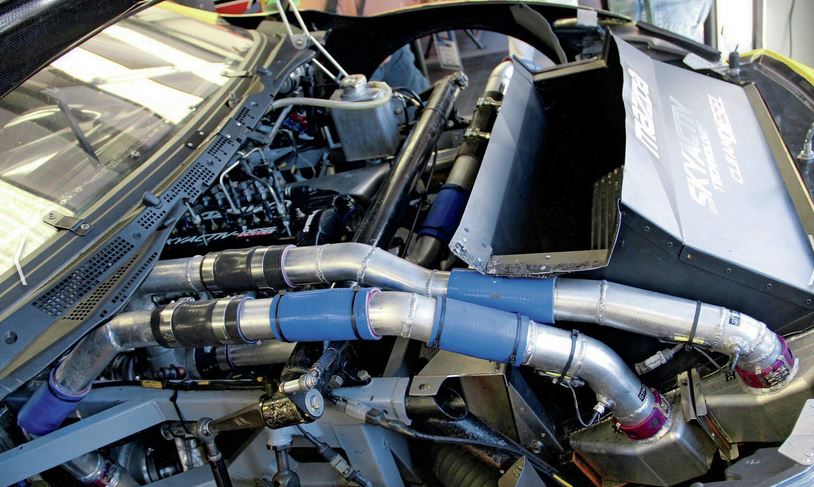

To ni ni?. Za dirkanje navijejo ta dizel motor na 4o0 konjev in zdr?i. Se pravi,da ima veliko rezerve.Ampak kako je pa z menjalnikom in sklopko je pa drugo vpra?anje.
http://www.trucktrend.com/cool-trucks/1403-inside-the-400hp-mazda6-race-cars-diesel-speed/

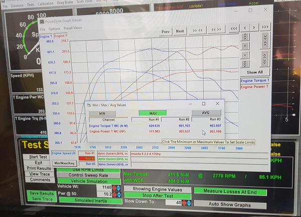

Za 2,2 dizle je ?ipanje na 210 PS ?e dolgo znana in preizku?ena zadeva: http://www.css-tuning.com/galerija-vozil/mazda/mazda-6-22d-skyactiv-150-hp
Bencinarji pa so toliko bolj redki, da je te?ko najti uporabnika z izku?njami iz prve roke. Tudi na njihovi strani v galeriji ga ni, moj avto pa se je na seznamu mo?nih tuning kandidatov pojavil na dan, ko sem jim poslal povpra?evanje. :)
Cena naj bi bila okoli 300 EUR z vklju?enimi dyno meritvami.
OK, uni dirkalni dizli imajo kar 63% original ma?ine ampak to vklju?uje vse ?raufe, blok, glavo... Vseeno je impresiven podatek, da blok zdr?i.
