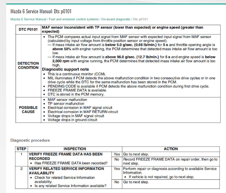

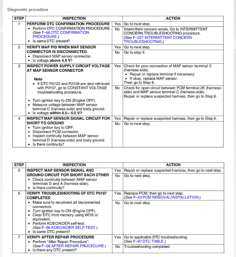

Tole je procedura za MAP, kako se lotiit, ampak predvidevam da itak nima? voltmetra  v avtu. Lahko proba? kak MAF resetirat recimo preko FORSCANA. Mogo?e bi proball MAF spucat z namenskim sprejem, ampak imam spet ob?utek da to ne bo dovolj.
Visually inspect all MAF sensor wiring and connectors to make sure they are intact, not frayed, broken, routed too close to ignition wires/coils, relays, motors, etc. Visually inspect for any obvious air leaks in the air intake system Visually *closely* inspect the MAF sensor wires or film to see if you can see contamination such as dirt, dust, oil, etc. If the air filter is dirty, replace it with a new original equipment filter from the dealer Carefully clean the MAF using MAF cleaner spray is generally a good DIY friendly diagnostic/repair step If the air intake system has a mesh in it, make sure that is also clean (VWs mainly) Loss of vacuum to the MAP sensor can trigger this DTC A low minimum air rate through the sensor bore may cause this DTC to set at idle or during deceleration. Inspect for any vacuum leaks downstream of the MAF sensor. Use a scan tool to monitor real-time sensor values from the MAF sensor, O2 sensors, etc. Check for Technical Service Bulletins (TSBs) for your particular make/model in case of known issues on your vehicle The barometric pressure (BARO) that is used in order to calculate the predicted MAF value is initially based on the MAP sensor at key ON. A high resistance on the ground circuit of the MAP sensor can cause this DTC to set
Read more at: https://www.obd-codes.com/p0104

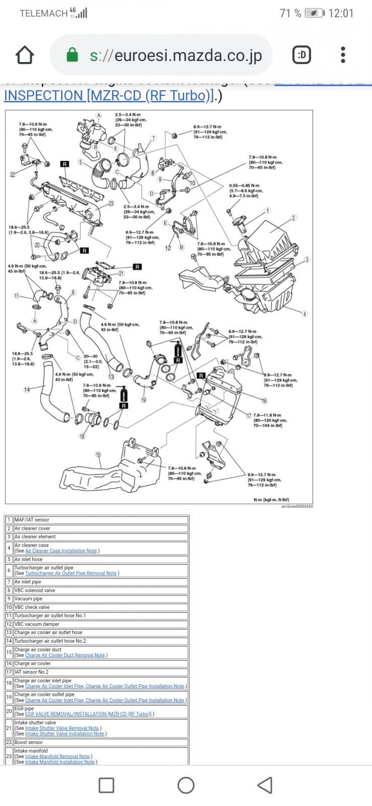

A to mislis ta VBC solenoid valve (st8)?
2008 Mazda 6
2004 Mazda 3
kurckej vidim na tej sliki... to je tista zadeva, ki spreminja geometrijo lopatic turbine.

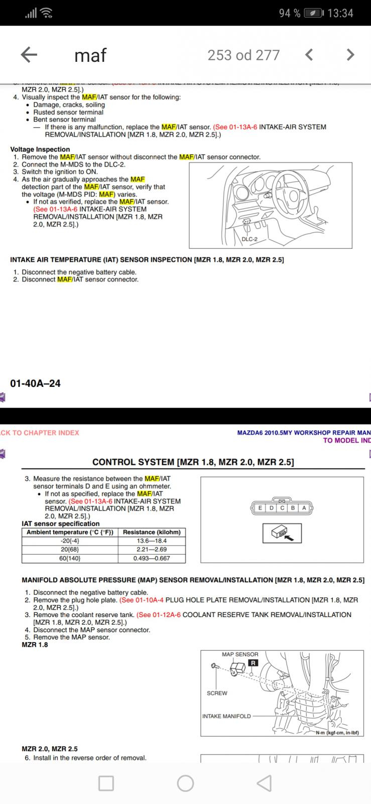

Spodaj sem prilepil postopek kjer so napisane vrednosti
